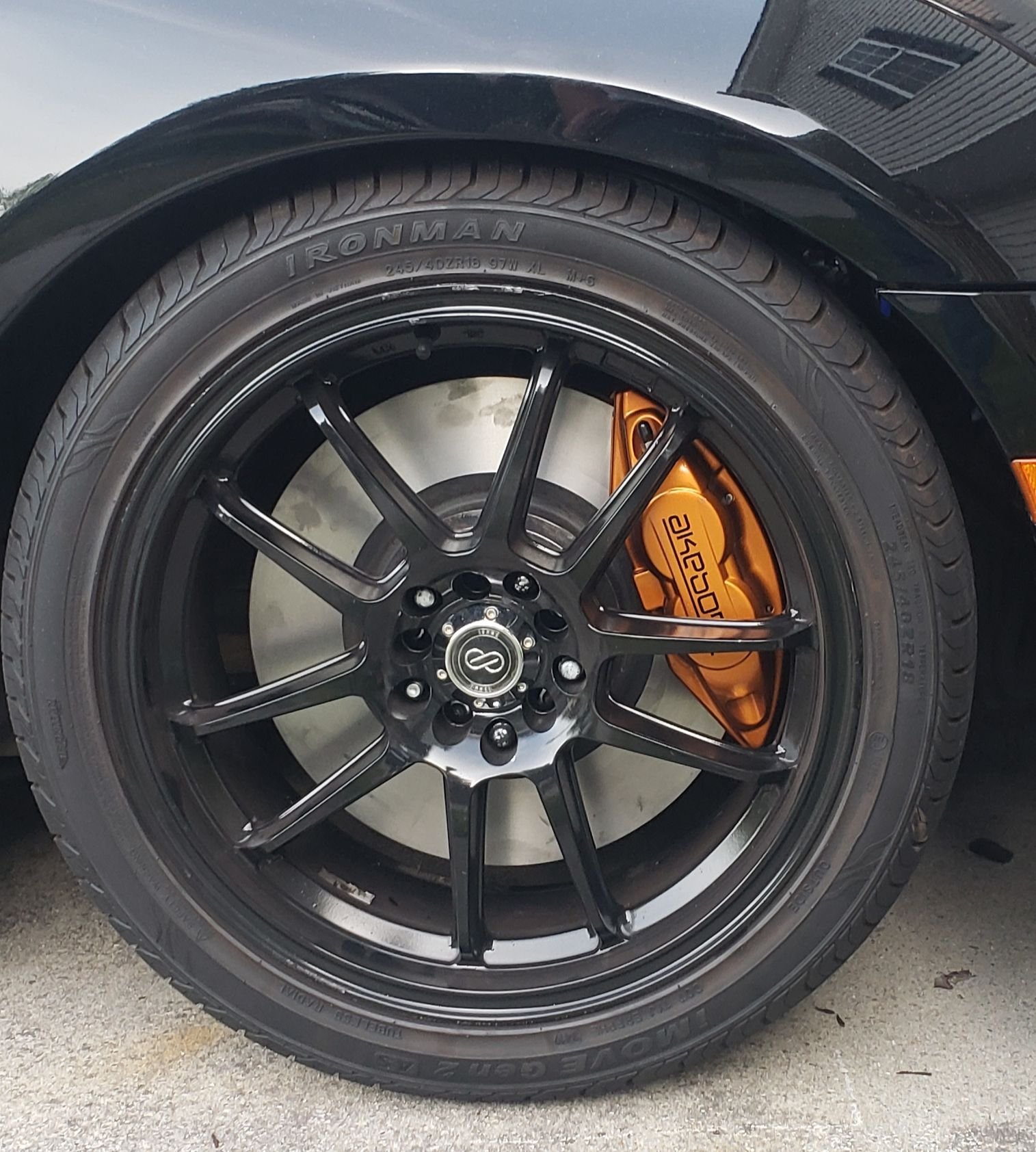

Went and got the brackets from z1, z1 ss brake lines, rotors and pads to install akebono kit tomorrow and on the way home my f#@kin passenger side window motor goes out smh....will post pic tomorrow of the new set up.

Put the bbk on, akebono of course all in cost me about 750 that's with calipers, turned rotors, z1 brackets, z1 ss lines, speed bleeders and front and rear new pads and czp decals. So I'm still 1000 under budget.

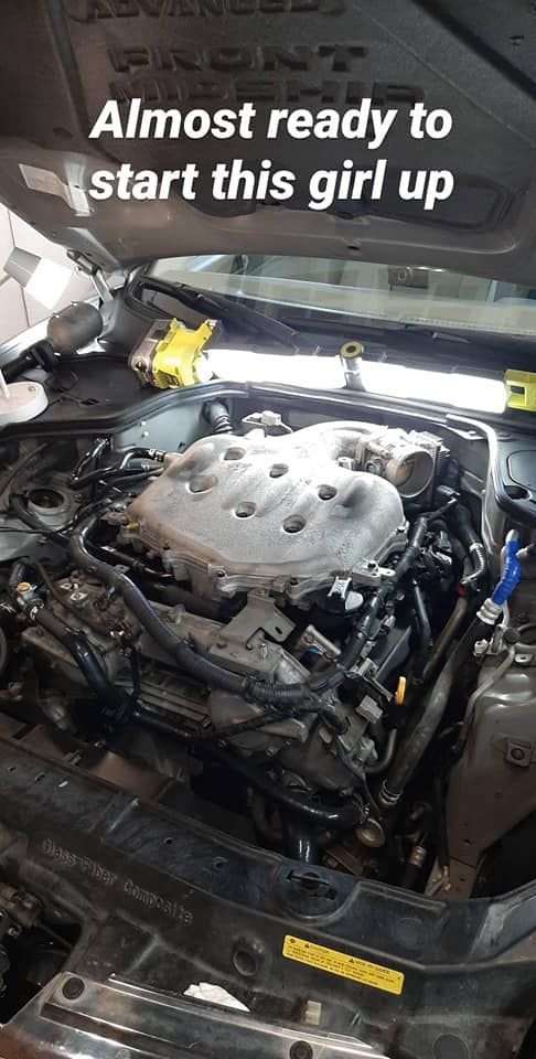

New NGK spark plugs, new valve covers and all the gaskets, new o2 sensors and axles
$900 later, she’s running good

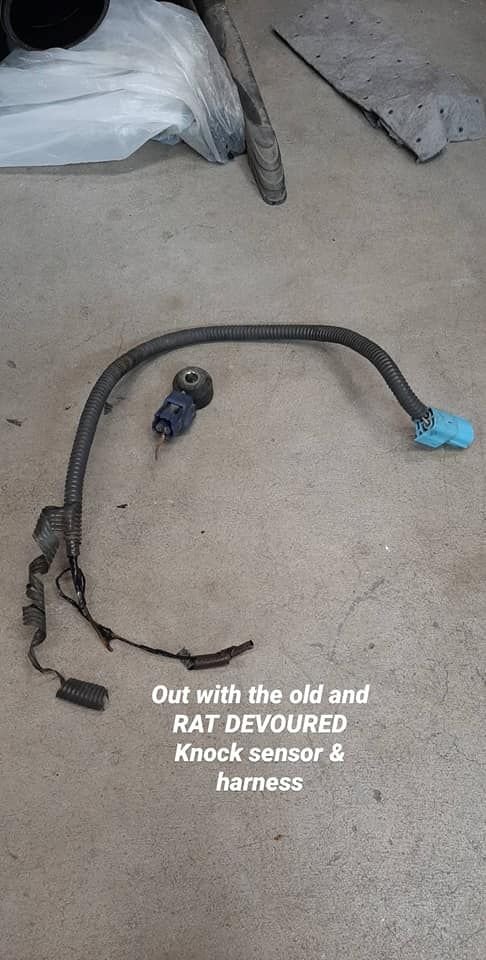

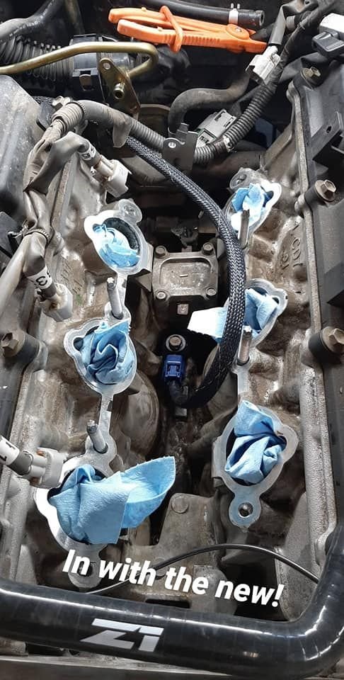

Replaced my knock sensor + harness, and added a Motordyne 5/16" plenum spacer on Saturday 5/16. A rat decided to munch through my harness, but oddly enough I had ZERO check engine light
I only learned I had a code of any sort when I plugged in DataScan 2 for the first time on earlier that week. It showed P0327 active. My scangauge and Innova scanners showed no codes at all. Must have been pending??? Being the impatient millennial that I am, I wanted to nip it in the bud right away.
Super thankful for ConceptZ. I ordered my all parts Thursday night for Friday overnight shipping, Saturday delivery too! I checked tracking like a hawk, and sure enough FedEx express rolled up at 10am Saturday. The only part I had to venture out for was the O-ring for the fuel line.
The biggest frustration was trying to disconnect the original knock sensor harness. There is a small bracket and fastener holding in a very bad/awkward position under the coolant pipe on the passenger side rear of the motor. I spent 20 minutes fighting it, then finally got it out. I ended just zip-tying the new harness and connector the main harness running across the top of the bell housing. Torquing down the lower intake manifolds was a pain, I had manuever the socket and extension around the fuel rails. If I were to do it again, I'd order the injector o rings and do it the whole 9 yards. But suffice, live and learn.
I snagged some nice insulation from my work since we have thousands of feet of it we rarely use. Everything else is relatively straight forward, be ready for spilled fuel and coolant, and maybe a little oil too from the plenum.
I also replaced the small coolant lines running to the intake, but I forgot to install the damn valve! Oh well, next weekend maybe!
Very happy with the performance of the plenum spacer. I reset the ECU with datascan and thought I would need to do an idle relearn and throttle closed relearn, but the car idles and runs fine, so I may screw around with it later.

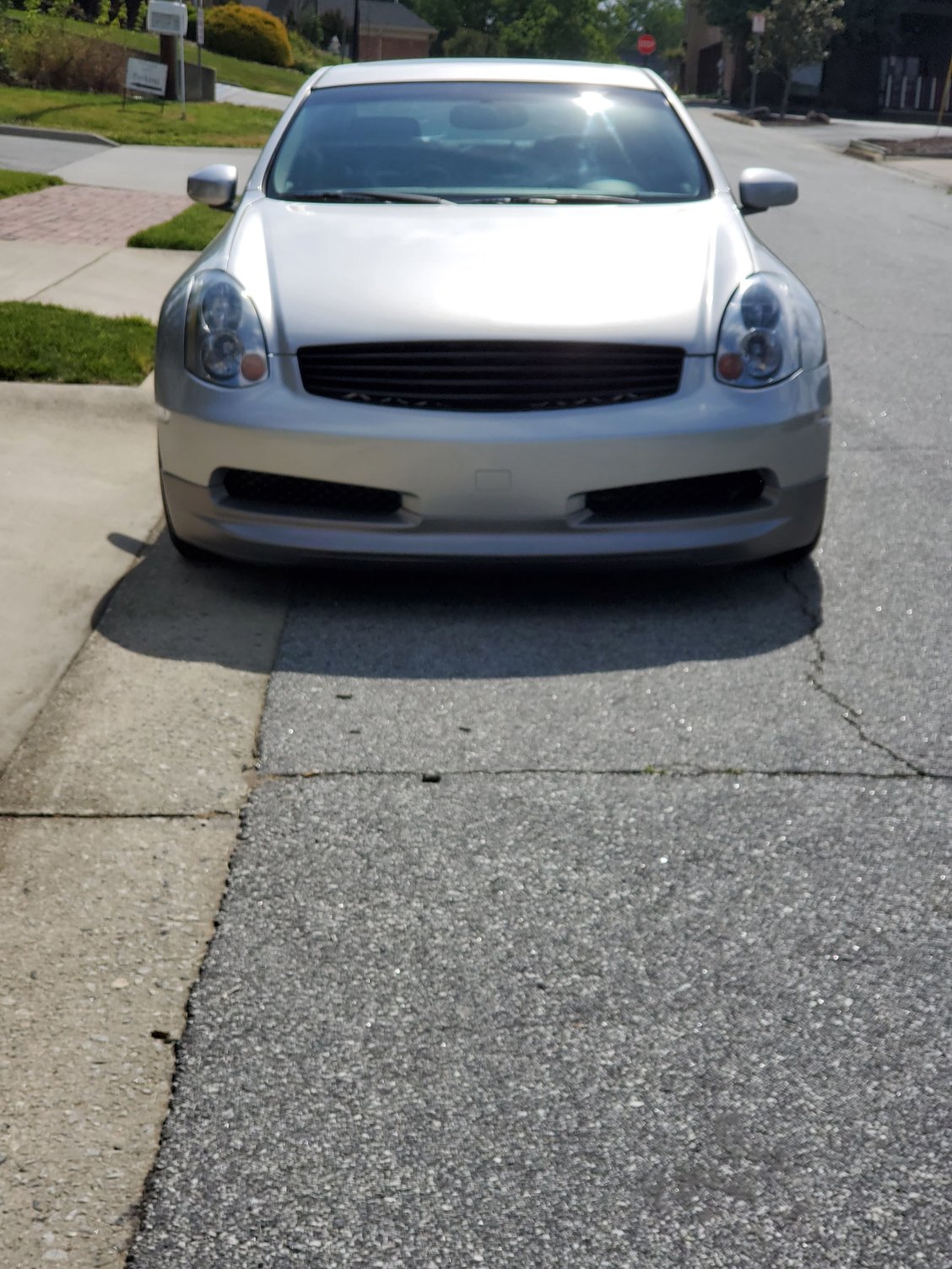

Picked up a Badgeless grill and installed my front lip

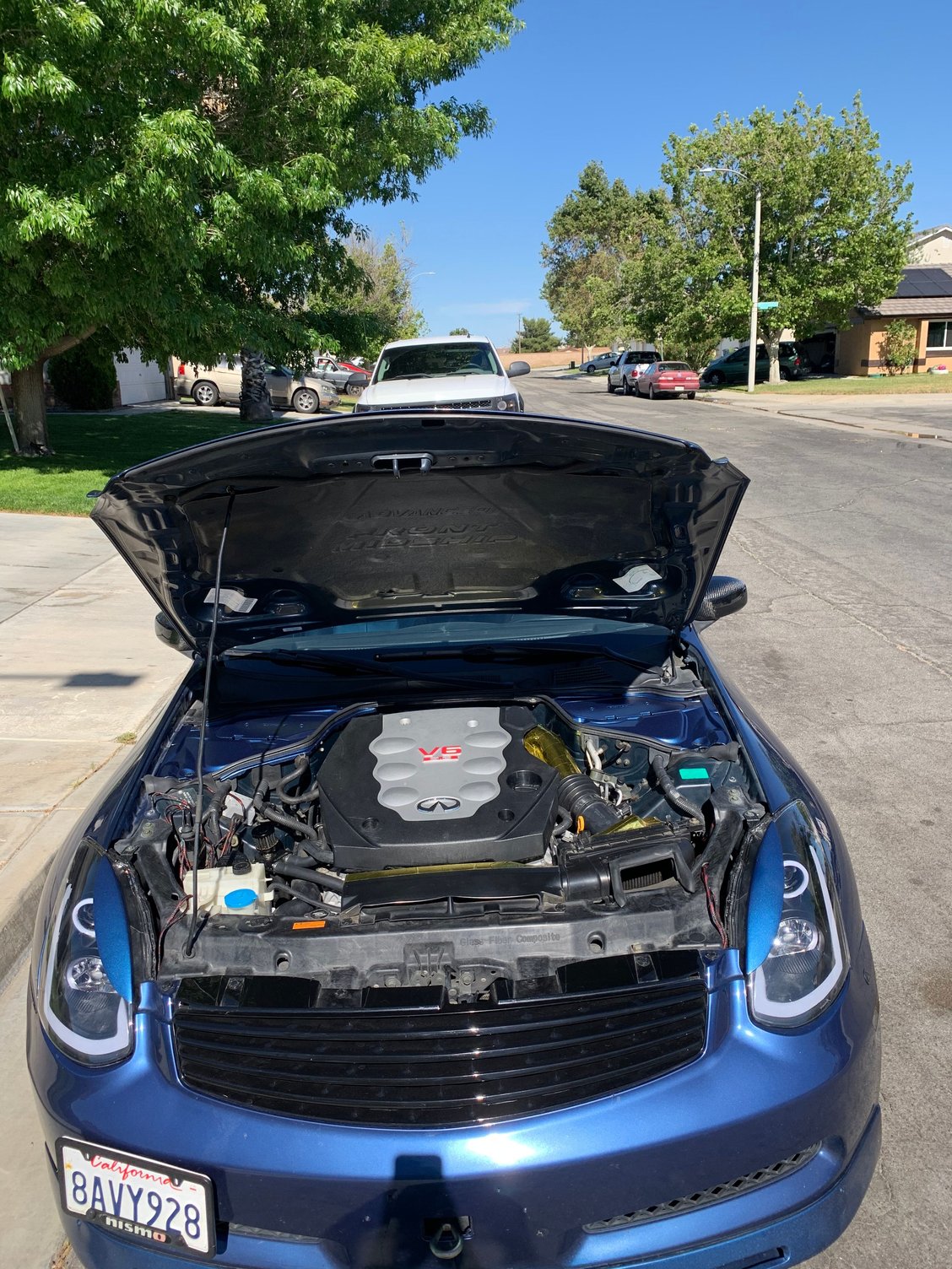

Paint matched the battery and JDM battery cover

Wow that looks really clean with those painted.
