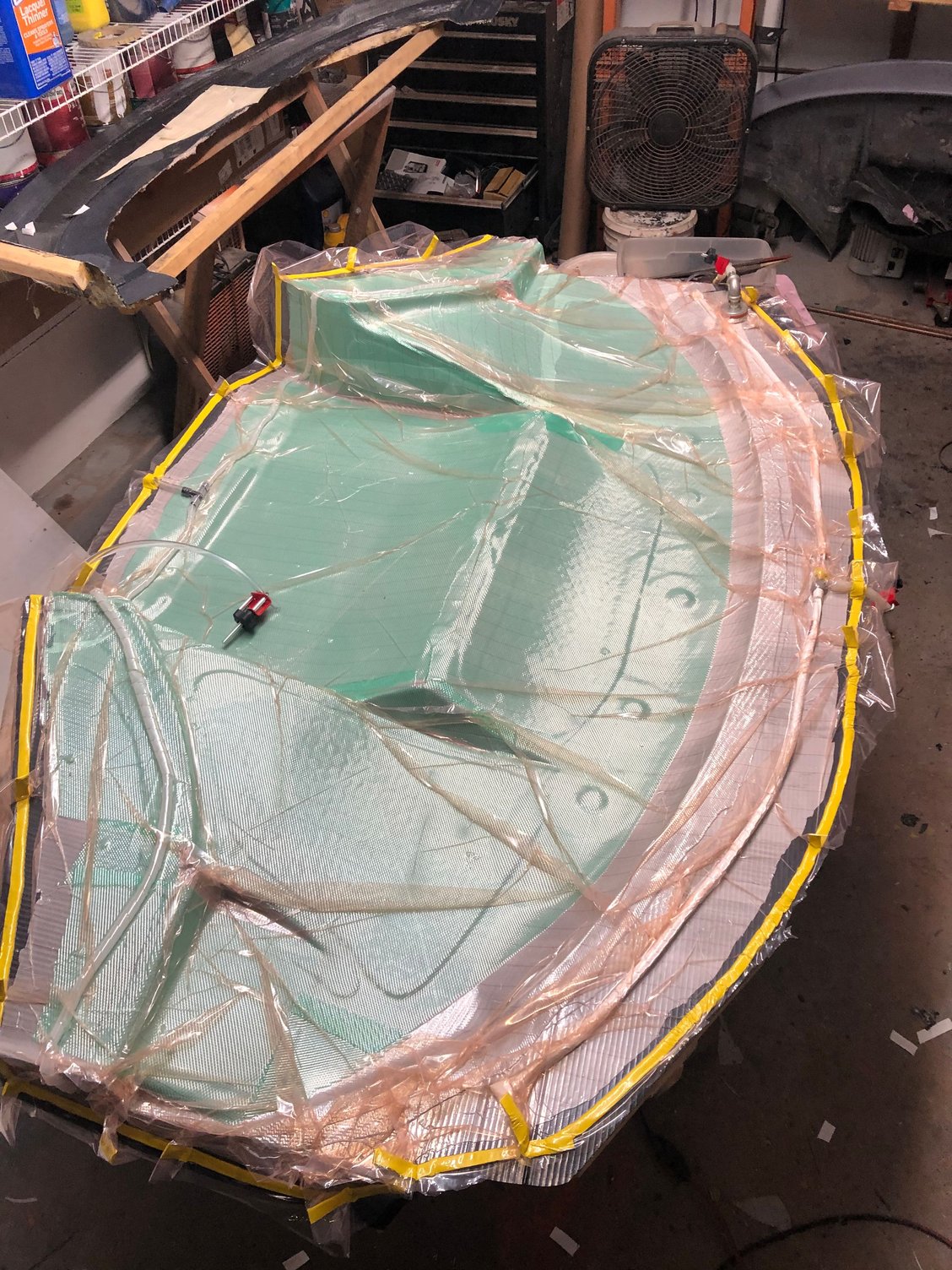

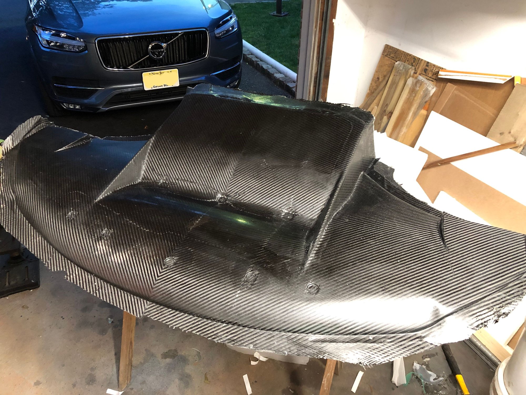

I really want to make a CF roof for the G35 coupe, but I don't think my skill level is there yet as proven to me this weekend. The infusion of the bottom shell of the splitter went rather ....embarrassingly.

I'lll make one eventually. Certainly for the splitter build thread showing both the wins and fails as there were quite a few (turns out this composite stuff is kinda hard).
I did get the infusion done on the bottom shell on Sunday, but honestly not happy with it. I made a number of dumb mistakes (mis-weighed the resin to hardener so it kicked too soon, didn't pre-heat the mold, plus other rather embarrassing mistakes which lead to a horrible infusion). So for all the prep and time spent on laying everything up, the bottom turned out like shyte. It's fixable and usable, but if it wasn't under the car I would have scrapped it. Big bummer on such a large part with so much $$$ in raw materials alone, but oh well, good learning experience.
So the bottom shell turned out to be a fail in my book, although still usable after I fix some spots. You can see some channels that formed in the very center around the 3 center mounting holes when I had to release vacuum (because I made more dumb mistakes and was desperately attempting to fix them). Sharp learning curve with this stuff.
