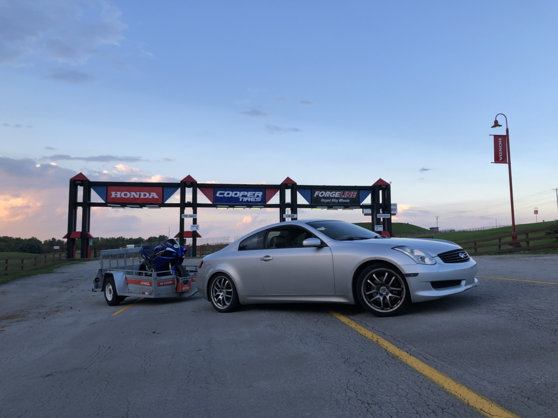

Got 20 mpg to and from the track this weekend. The G pulls super well when you get the crash bar bracket reinforced .
Will have to bring the car here next spring.
