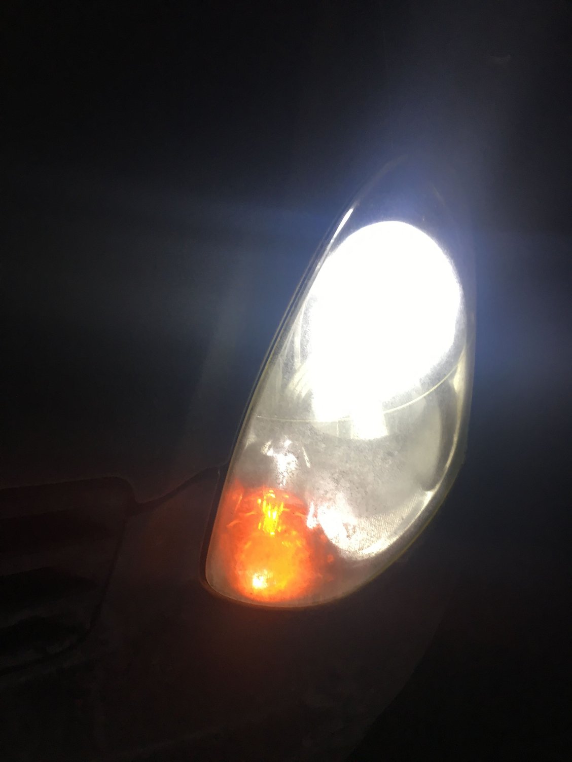

What type of bulb is this?

Big thanks to G35Papa for putting together this light chart!
Description----------------Bulb Type
HID Low Beam-------------HID-D2R
Non-HID Low Beam --------H1
Fog / High Beam-----------H4 / 9003
Reverse Light--------------W2 / 921
License Plate Light---------168 / 194
Clearance Light------------168 / 194 (03/04 only)
Side Marker---------------168 / 194
Interior Trunk Light -------158 / 168 / 194
Map Lights----------------T6 / DE3175
Dome Lights---------------T6 / DE3175
Step Light-----------------T6 / DE3022
Front Turn Signal----------7440 (03/04 only)---7443 (05/06 only)
Rear Turn Signal-----------7440 (03/04 only)---7443 (05/06 only)
