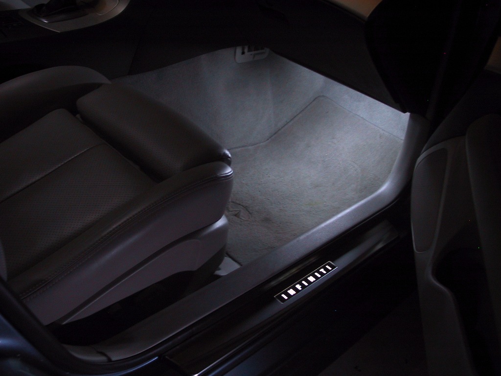

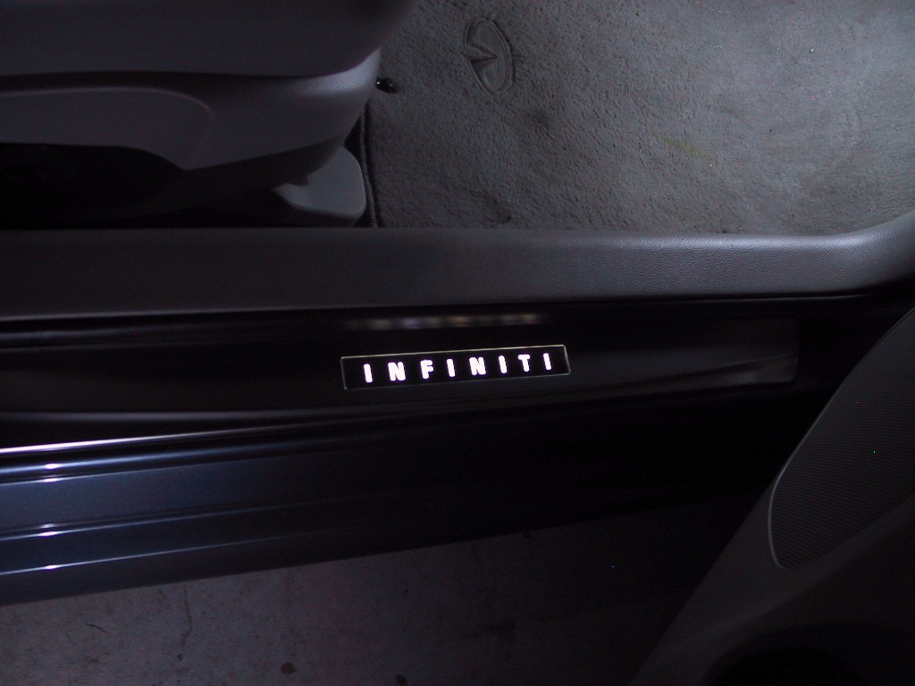

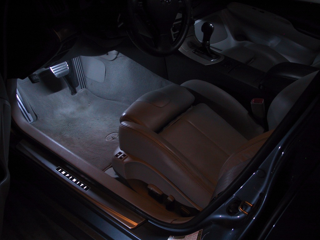

Kick Plates & Footwell Lighting
I bought and installed the kick plates a couple of weeks ago. They look great and add some more class to an already classy car.
A while back, I noticed that the footwells weren't lit. I thought that was odd for luxury car such as the G. So I bought a couple of neons to place up under the dash above the footwells, but I couldn't figure out how to wire them in to the door activated lighting. So when I installed the illuminated kickplates, I just tapped into it's harness for the footwell lighting. It looks great and adds a lot of class to the car.
I've also installed bright white LEDs throughout the car, much better than stock yellowish lighting.
Here's some pics....
I believe there's an OEM kit that you can get from the dealer that adds the footwell lighting. But it's ridiculously expensive. You did a great job! looks sweet!
Looks like you beat me to the punch w/ the footwell lighting. Lookin' good
