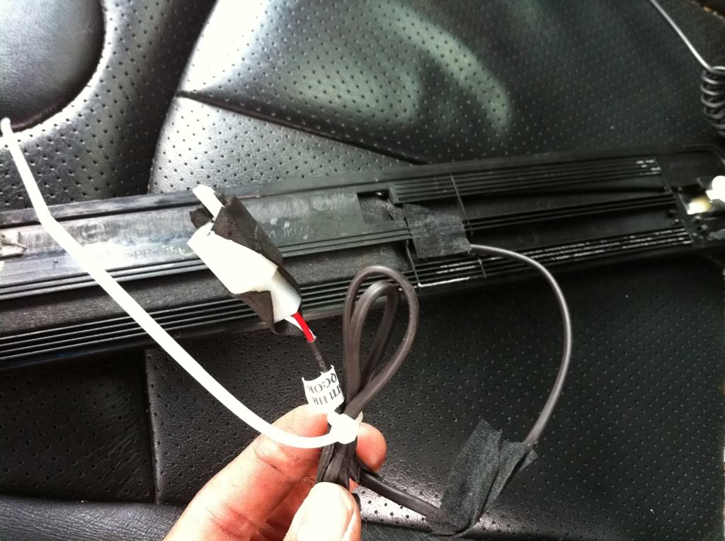

These are the plates I got. Cable looks short!
Old Feb 26, 2011 | 10:42 PM
  #261
rustyeleio's Avatar
Joined: Jul 2006
Posts: 274
From: Hawaii
I think that Aeson is correct. The wire was hard wired to the kick plate but I am not positive. I forget what it looked like when I installed on my 08 sedan. The driver side definitely had to go all the way over to the passenger side kick panel where the OEM "box" is located.
Assuming that it was not hard wired but an extension adapter that came with the kick plate, maybe ask the guy you bought it from to check if he has the rest of the cable still under his carpet. I bet he just forgot that there was an extension that was part of the kit and not part of the car.
I will try to see if I still have the instructions that came with the box. It wasn't hard at all but you definitely need the correct plug at the end.
Old Feb 27, 2011 | 06:41 AM
  #262
rustyeleio's Avatar
Joined: Jul 2006
Posts: 274
From: Hawaii
Salvador312,
You are missing a really big part of the wiring. There was an adapter that plugged into the main module by the passengers foot. It had the wires that led to both kick plates, driver and passanger. The plugs in your photo are "intermediate" plugs. Without the main wiring harness, you cant do anything. Go back to the person you got it from and ask him to look for part D in the manual I have attached. He must have forgotten that it didn't come with the car.
