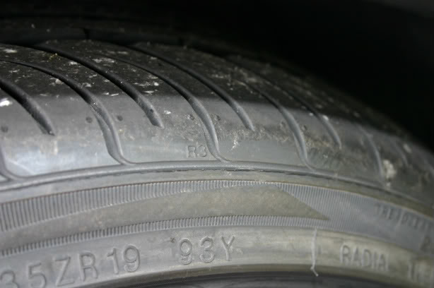

Originally Posted by 4DGS
Well you shouldn't need the alignment since you didn't change and suspension. It COULD be out of wack though.
9.5 +22 should not be rubbing what so ever on a stock height car. The fronts sound like they're probably rubbing on the fender liner screw at about 12 O'clock. Remove that and see if the rubbing goes away. The rear sounds like you have blown struts or the rear is sagging out and banging wheel.
Find someone to roll the fenders to be safe but I have never heard of a coupe rubbing with specs like that. My Z has unrolled fenders and its 10.5 +22 (12mm more aggressive than yours) and it doesn't rub even in hard corners.
I needed an alignment before I even thought about wheels, but waited to get it done all in one shot. Then the shop I went to wasnt able to do it
I think i see the liner screws you're talking about. Heres a pic of where I think the tire is rubbing. You can see the marks on the sidewall pretty well, most of it wiped off though. This is from those screws right? And it's fine to just take them off?

Yea Calamity, looks like that is the issue. If you're getting them rolled the guy or shop should be able to point out and other problem spots (if he has any idea what he's talking about)

I removed one of those liner screws and it seemed to fix some of the front rubbing. The rear is still banging when I go over dips at a decent speed though.
The guy doing it is local, cheap, and real reputable, so i'm not too worried. Kinda makes me regret not getting the 19x11 rear now lol. Guess spacers and a drop will be in the near future though.
