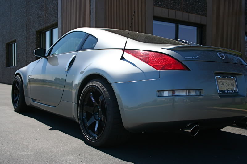

You want to know roughly what specs those wheels would be if that car had say, -6 degrees of camber in the rear?
1. It looks like excessive stretch (not needed)
2. Camber looks less than -6
3. I'd guess a 19x10.5 with a 235/35, -15 offset and maybe -5 degrees of camber tops.
Get me some more photos and I'll try and give you a better opinion.

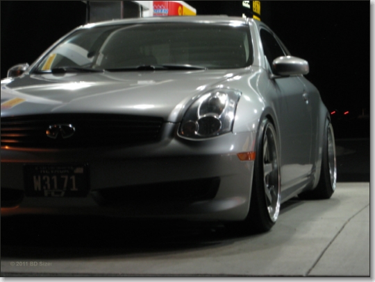

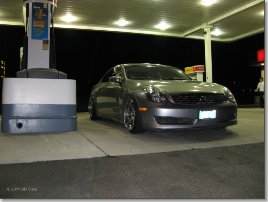

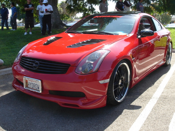

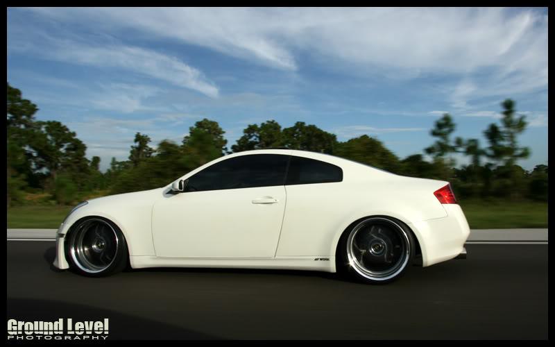

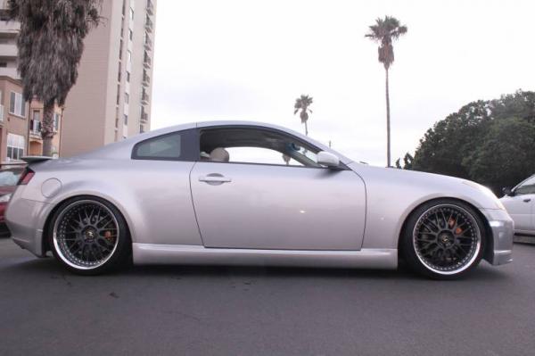

I'm looking to purchase wheels and tires for my 04 coupe. I'm a fan of the tucked look and not so much of the wide stance. I want to make sure I get the offset and tire size correct before I order. I want to lower the car too and have no ideal which springs are better. I'm after 19 inch staggered wheels and curious what offset and wheel size I should go with. I'll post a few pics of some cars with similar looks. I just want to avoid rubbing and excessive tire wear. Daily driver, not for racing.Thanks for any input/help.

19's are pretty popular, 19x9 front and 19x10.5 is pretty standard. Some where around +10 offset for the front and +20ish for the rear. That will of course change with the wheel width.
How much ground clearance do you want/need?
If you go with 19's you can tuck tire, but you will be pretty low unless you go with a tall tire.
If you go with 20's you will have a little more ground clearance when you tuck tire.
245/35/19F and 275/30/19R (or 35 series rear) are pretty common sizes for those wheels above. I would go for a 285/30 rear.
There are others on here that are a lot better when it comes to coupe offsets, Take my advice as a starting point and hopefully one of them will chime in to asist you further.
