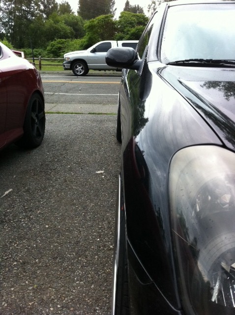

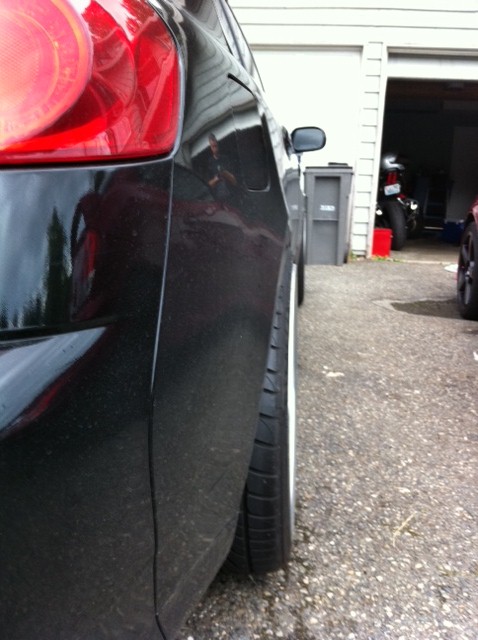

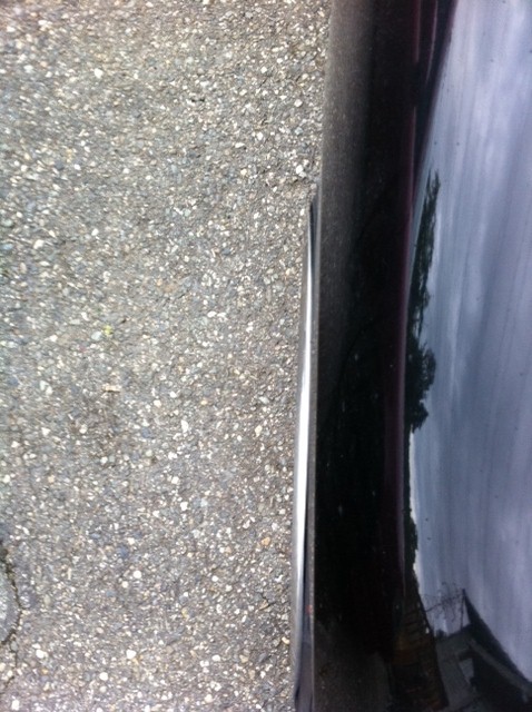

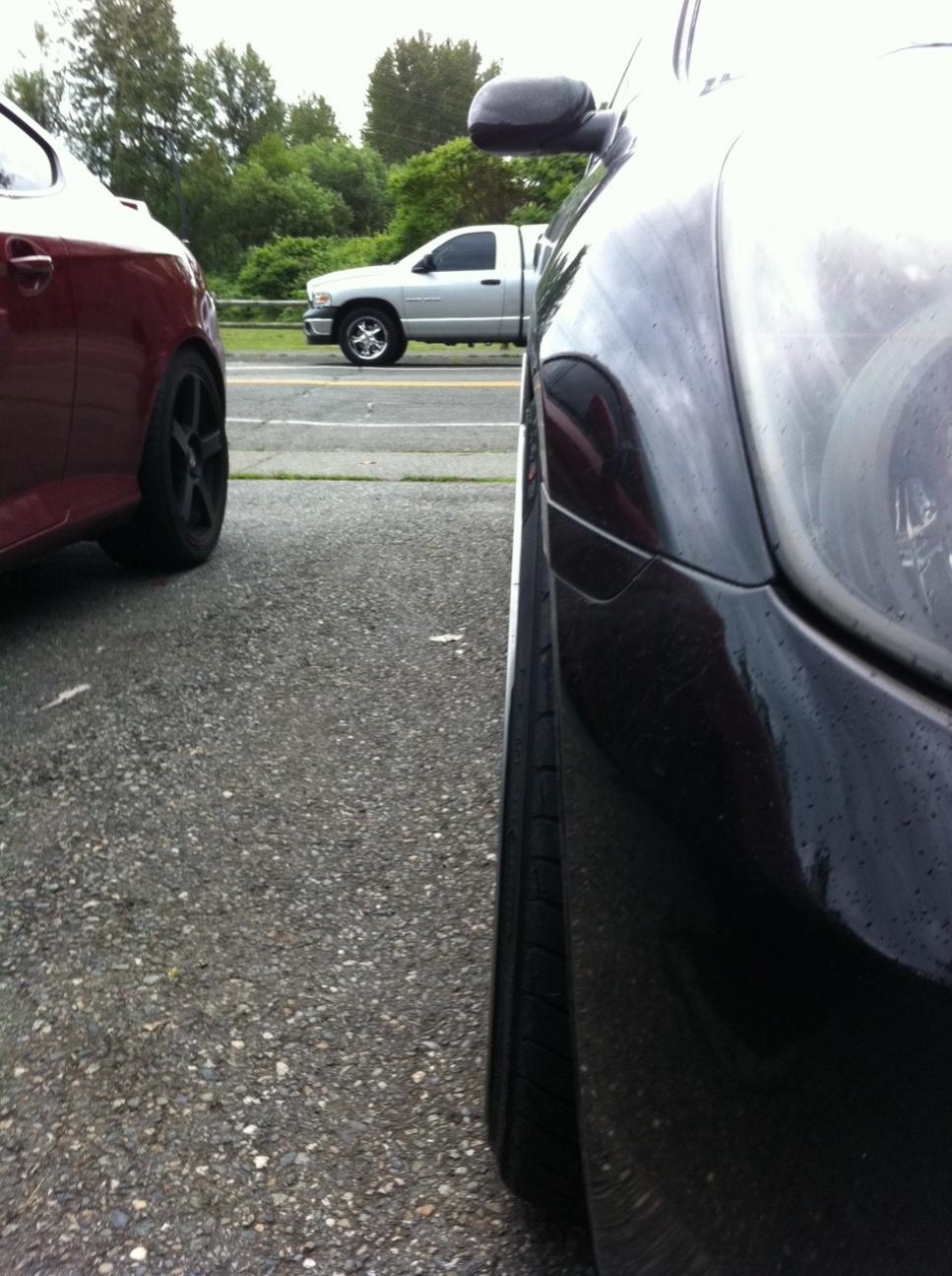

[ATTACH]Attachment 140896
[/ATTACH]I'm trying to decide on what size of front spacer to go with. The front wheels are 20x9 and sitting at +20 w/225/35/20. I am trying to decide if I should stay where I am or add a larger spacer. Rear wheels are 20x10 +25.
I think that I have enough room to go to +15 without issue. I just want to match the front to the rear. I think im almost there, but im not sure if +15 would be too much. I do have to order another set of spacers so I'm thinking either +18 or +15.
