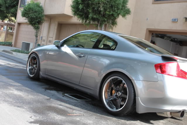

anyone know what kind of rims these are? and are they machined black or something of that sort? lol thankss
Old May 15, 2010 | 05:42 PM
  #935
Dranom's Avatar
iTrader: (109)
Joined: Apr 2008
Posts: 6,819
Likes: 34
From: Costa Mesa-714-
^volk GTS dunno the color though
looks like diamond black to me.
