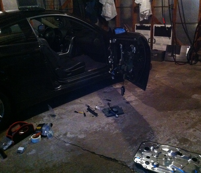

Awesome DIY! I am not one to work on his own car, but I decided I would try to tackle this task. Well... I was forced into doing this DIY "solo" at 1am on monday morning hours before I had to be at work... My windows have both been acting up for a good 4 months & I just try to ignore rolling them down, so I don't have to deal with the hassle of it messing up. The driver side window went down late sunday night and I was in a panic when it would not go back up after 25 plus knocks on the door. I followed all your steps in hope that cleaning the inside of the motor would solve the issue.... Well IT DID! but i know it won't be a fix for life. I am going to buy new motors for both sides from autozone next week and have a dealership install them for.
Heres a few iphone shots:
I started this task at 1am finished at 4am and was at work on-time at 9am.....
