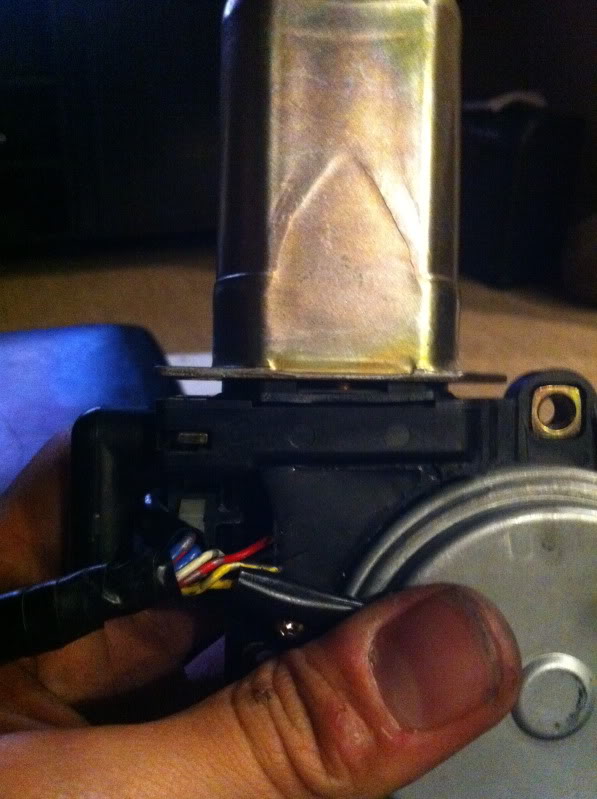

I cant put the copper piece back into the motor. is there a certain way to put it back in? im so close to it fitting snug but i have literally been trying to do this for 4+ hours
