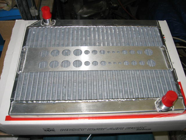

I bought mine used and installed the kit myself. the only thing that you have to buy from Stillen is the heat exchanger under the supercharger. the front inter cooler and the water pump you can find online. I do have an extra new heat exchanger if you're interested.
Hey, thanks for the offer but i don't have the kit yet, i was just pricing one out, to find the best S/C for my money. How much do you think i can get the IC, heat exchanger and water pump for online? and would you recommend getting the 36,000 mile warranty?
I've got a 300ZX also. i drive that daily, just single turbo shiro though.
