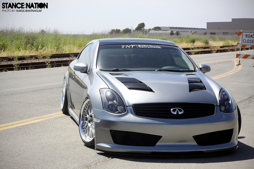

talk with thaistyle about the supercharger stage 4. I just helped him installed it. The hood fits perfectly with this kit, no gap or nothing with it. He had the whole body kits btw.
Here are a few pics of it:

That's crazy that hood doesn't have an issue with the blower!??? Neat!
What exactly is involved with the Stg4 "kit". I know it's a smaller pulley (I believe) and what else?

hi guys! im here to address the hood/gap issue. there's no issue with the hood, it only appears that way because of the bumper that it is paired up with the k2 has an integrated grill with no support bar in the middle. this causes the grill to sag down a little bit, hence the gap between the bumper and hood. however, if you are running an oem grill, it wouldnt be a problem.
