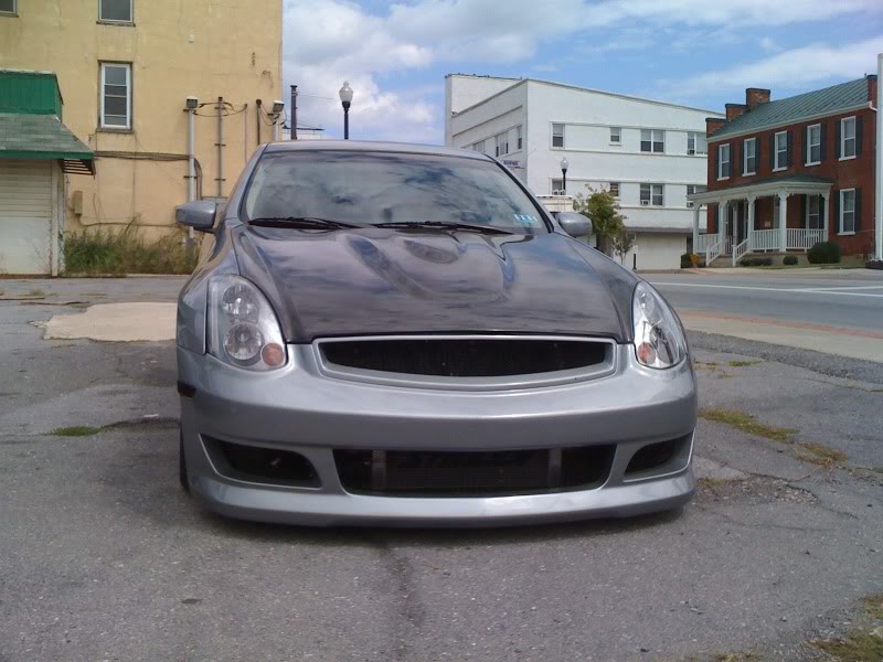

k2 bumper installed!

looks good!

Looks real nice.

Looks BAD @SS BRO!!!!
Did you notice any improvement over the previous bumper you had (assuming it was most likely the OEM?). I just see that the intercooler will get hit hard with a nice flow of air....
Let us know....

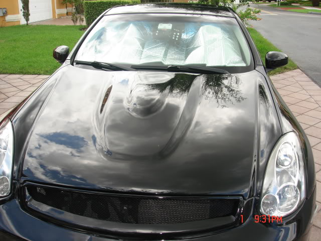

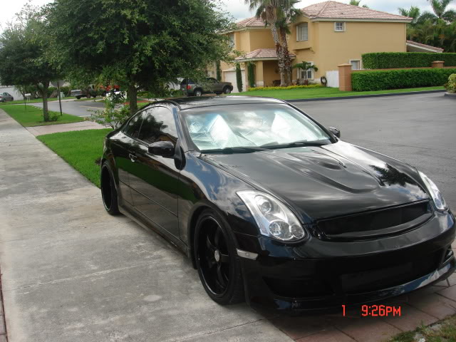

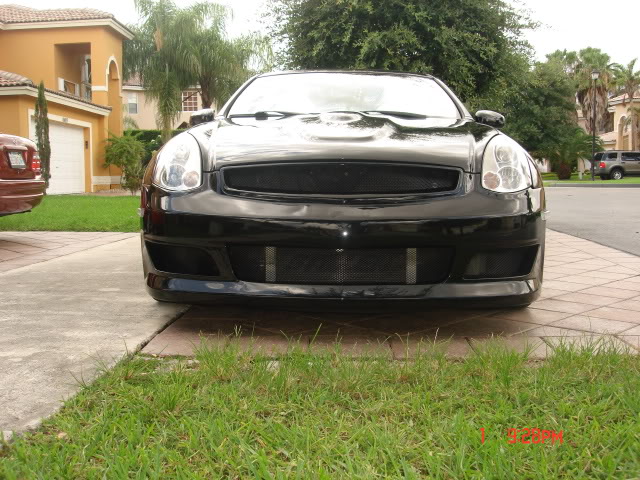

1. 2006
2. Coupe
3. Auto
4. 20x11
5. 280rwhp
6. 260rwtq
7. dotn have type off memory.
8. Stage 2 (have stage 3 pulley sitting in my room)
9. Stillen Tru Cat Exhaust
Ive had this car for since January 2009. It came straight from the dealer, 0 miles, with the S/C kit. I am second owner, and i bought it with 7k miles on it. Im at 29k and ive had nooo problems so far, except at about 10k miles, my snorkel belt snapped. I was running the original 4 rib setup, and upgraded to 6 rib. No problems so far.
I am interested in upgrading to Stage 4. And ive read a lot of posts, and most people make tops 320. Im not a power junkie, nor plan to be. This car as it is now, satisfies my needs. But there are some things i want to correct.
For example. A few months ago, i rear ended someone, and dented my FMIC. It is still functional, but looks liek ****. Besides that, its really small and looks pathetic. I really want to upgrade the FMIC radiator. Will regular radiators (GReddy, AMS, etc) from Air-to-Air coolers work properly in a Air-to-Liquid system? Id ask stillen, but you guys know how that is lol
Second inquiry, i saw that there is yet another hood that fits with the Supercharger kit. Is this really true? id love to get a new hood. That hood would be sick nasty. Please let me know, as this would probably my next investment.
Next inquiry, i questioned Stillen about buying other mods, such as headers and cat deletes. They told me that buying headers would lower the boost of the supercharger, there for, reversing the effect of any upgrades. Is this true? I would love to get me some headers, and get rid of these cats!
Final inquiry, as i said before, i know this kit isnt a powerhouse, and i accept it. But what mods have others of you done and gotten at least some more engine stability? Im picking up A LOT of engine heat, and i wanna see what else i can do to better the longevity in the engine (except removing the kit). Any help would be awesome. I would search the thread, but theres 33 pages ><.
Heres my ride
