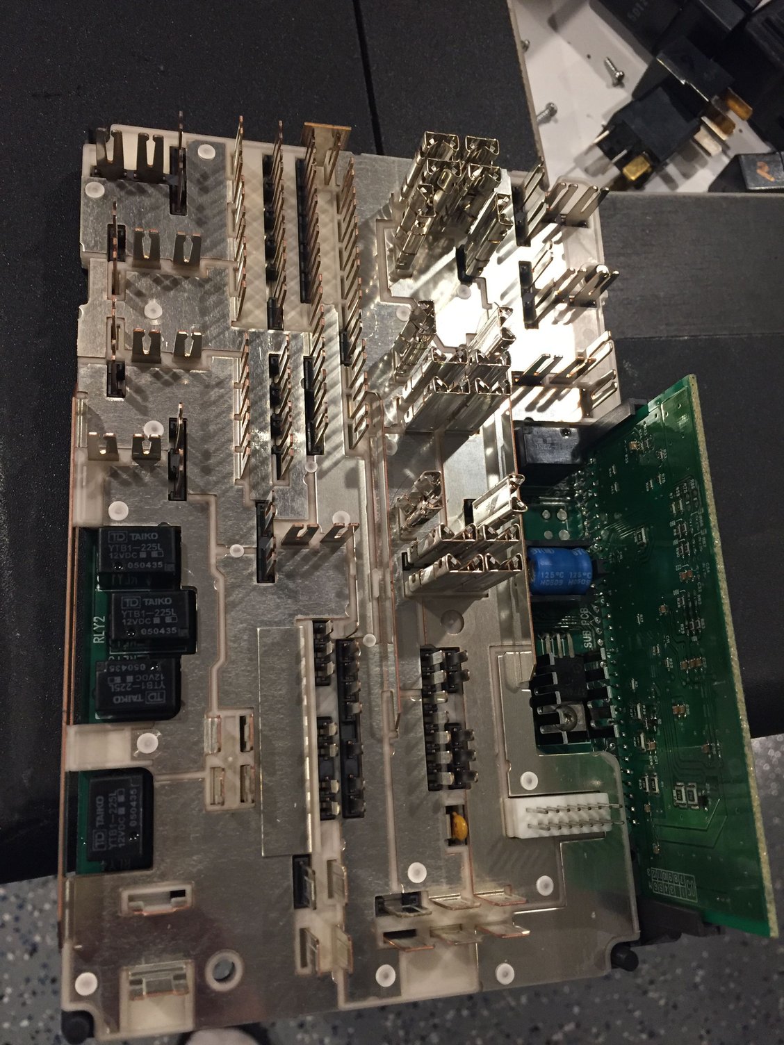

Got it open but holy crap! This thing is built with 3 layers of circuitry. I cant take it apart anymore without risking damage so im just gonna have to figure it out from here. For those of you wondering....Im trying to get my fog light switch to control my parking lights. That way I can turn on my parking lights without causing my dash to go dim.

Originally Posted by cswlightning
Oh I was going to open mine up to see if something in there could be the cause of my failing heated seats. How far did you have to go before you got to the heated seat relay?
There is no relay inside the IPDM for heated seats.
All I can see is a fuse for it but thats located in the small fuse box in front of the battery.

^the fog lights wont activate unless the head lights are on. how were u gonna work around that? the kp module is supposed to allow you full control of the fog light switch but that product is iffy
Exactly...thats why I gave up trying to work around it
I thought it would be a basic relay...just supply power and it will activate. Then I would route that power to the Taillamp relay, which turns on the parking lights. But no it isnt a basic relay, its a reverse system. It has constant positive supplied to it. When the headlights AND foglights are switched on, the CPU grounds the negative side of the fog light relay and turns the foglights on.
So I said screw messing with all that reverse electrical system crap. I just decided I would not use a switch, and just have the parking lights come on when the car is started. I figured I would route power from the ignition relay to the taillamp relay...so when the ignition relay came on, it would activate the taillamp relay too. Well...I figured out which one the taillamp relay was in the "CPU" but I wasnt sure about which terminals I would use. Its not a basic SPST relay and its soldered into the board. I searched online and couldnt find a diagram for that specific relay. I need my car and wasnt willing to risk any damage trying to figure out the operation of the relay.....so I gave up on that too.
Next step! Screw it! I decided to supply power directly to the parking light wire coming out of the IPDM harness. I didnt wanna draw the power from anything inside the IPDM, since those are mostly essential for the car to keep running. So I decided to route the wire all the way inside the cabin to my seat heater switch. My parking lights draw about 3 amps and the seat heater is fused at 15amps and only powers on when the key is switched to Acc. Perfect!
