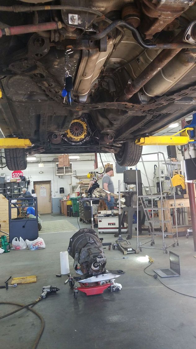

Dropped the tranny to install a machine balanced ebay 19 lb flywheel and z1 mild street clutch kit, as well as RMS and upper oil pan seal...
The 130k dual mass was completely toast and had tons of rotational and axial play, but turns out my old PP was a $700 ACT HD which still looks good!
engine is nice and smooth now even with full poly mounts, and I have less gear rattle than with the old shot DMF. Shifting is way smoother, and I can't get 5th to grind anymore for some reason.
Nice perceived power boost especially low RPM acceleration in 6th on the hwy!
