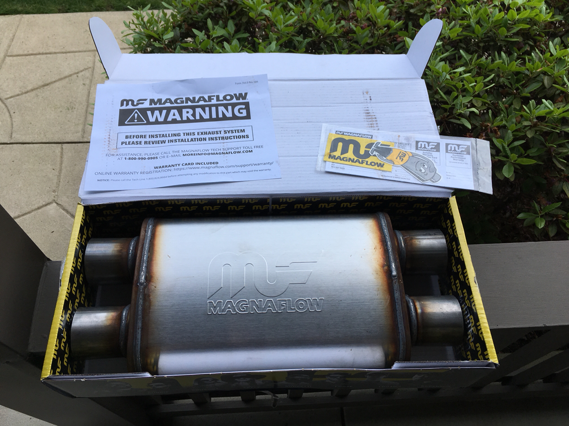

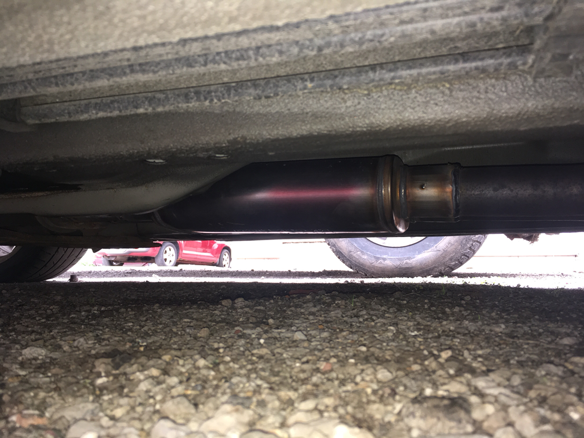

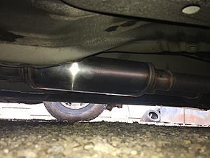

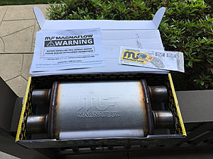

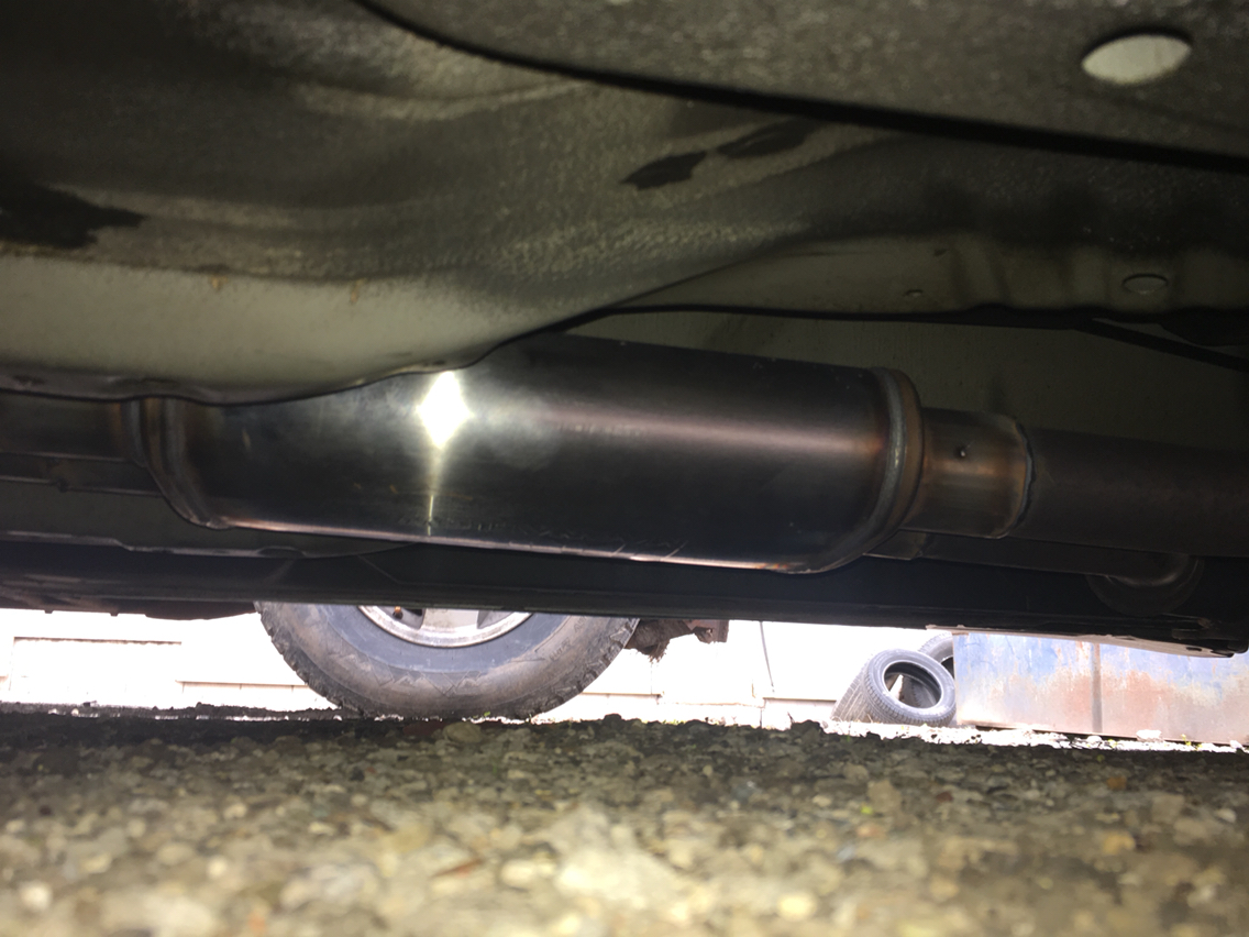

They are the HKS rep eBay thin wall 4.5" tips on his car. They can't be missed.
Originally Posted by cswlightning
G35 coupe, this used to be an HKS rep exhaust before every component was replaced at a muffler shop. The 11386 is after the flex pipes replacing the Chinese "resonators". It made the exhaust 100% better and livable for a highway daily, but I wanted more quiet, so I upgraded the China mufflers to larger volume straight through China mufflers branded "totalflow" for $30 a side plus $100 labor including welding in new flex pipes. Sounds nice and quiet unless WOT, but deeper and throatier than stock at all RPMs. No highway drone to speak of, at least compared to the original HKS rep.
I haven't done the back mufflers yet, but I'm pretty impressed with the Magnaflow X-pipe so far.
With the un resonated muffler section in the back, there is still drone at high load and low RPM in top gears, but otherwise there is none! Totally worth the $165 installed.
Drone much more minimal then when it was just the H pipe from eBay and when I tried to put fiberglass packs in there as replacements. X pipe FTMFW.
So all in on this HKS I'm $550 . If only I could've found a non rusty replacement for my OE one when I sold the Motordyne. My damn C pipe was corroded and my rear flange was toast on the Muffler and midpipe sections :cry:.
This set up drones less than the Motordyne setup did (auto trans). I'm still butthurt Tony didn't mention that on his listing.
Originally Posted by jparker7269
So is your G a coupe or sedan and a 35 or 37? Did you remove the 8" extension and cut the other length out and clamp it in or have a shop do it and weld it in? I have the HKS knockoff my self and really like it but does get a little droney at certain loads.
It goes behind the flex pipe. See CSW's posts... or my pics below.
IM FINALLY HAPPY WITH THIS WOOOOOOOO.
Attached Thumbnails What did you do to the G today?-photo363.jpg   What did you do to the G today?-photo97.jpg   What did you do to the G today?-photo402.jpg

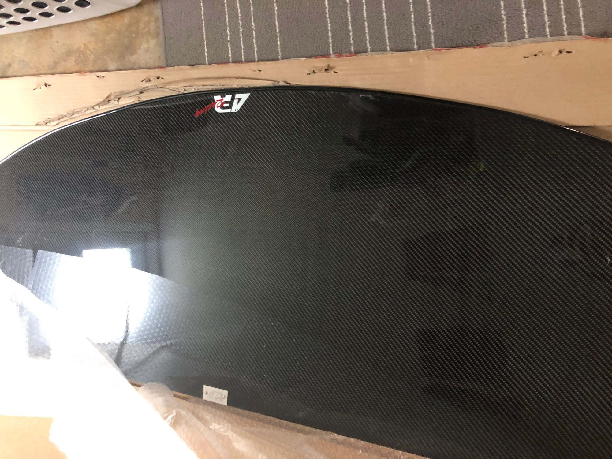

New splitter is here after 5 weeks

Dear god haha.

**** looks like an airplane wing

It'll look good installed.

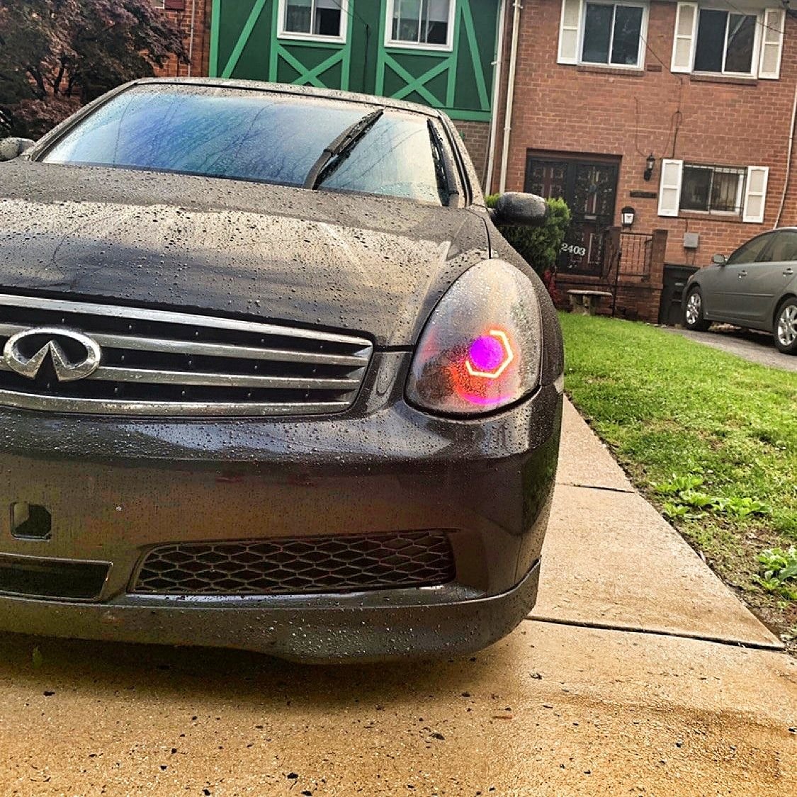

Snapped a pic
