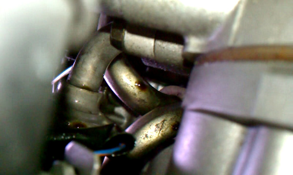

The hot oil smell has returned, yesterday I was determined to find its source. I removed the splash guard again and noticed an oil drip stain on it. I took me a little while of digging around but I located the source. Its above the AC compressor up high buy where the dipstick goes in but its not the dipstick. I attached a photo looking from under the car upwards.
She's going back to the dealer today. Even with that leakage I'm not losing anywhere near as much oil when the engine was consuming oil.
It may be a gasket issue or something not torqued down enough hopefully.
Aside from the leak the car is feeling stronger and stronger as I put on more miles I'm almost at 1000 miles now on the new motor.
