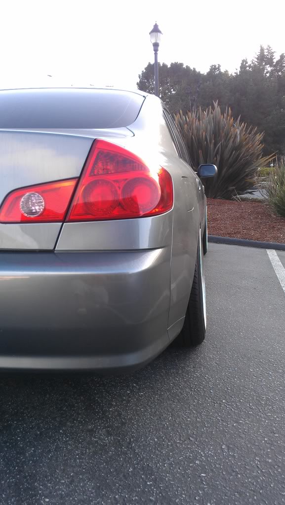

Old Oct 25, 2011 | 06:06 AM
  #2543
chink-ah-saur's Avatar
Joined: Jul 2010
Posts: 2,942
Likes: 297
From: AsiaSF,ca
Ok so time for smaller rubber in the rear, right now I have R: 245/40/19 on a 9.5 +20
And wanna get some + camber goin.
So Q is should I go with 245/35 with a little pull or 235/35 no pull

Originally Posted by P10 WRC
no the rears are 10 inches with 255/35's. i may go with 245/35's in the rear too.
For that mild of a stretch you can pick anything. You won't have an issue with them.
What's your camber at? about -2.5? What's your goal camber?
I'd do the 235/35 and keep the fenders stock. If you don't plan to go super aggressive then try to keep the fenders clean for as long as possible. Unless you know what you're doing with a roller or know somebody that knows what they're doing.
Old Oct 25, 2011 | 03:58 PM
  #2545
Joined: Jul 2010
Posts: 2,942
Likes: 297
From: AsiaSF,ca
Thanks.
Its in the high 4s I would like to be around 2-low 3s
Old Oct 25, 2011 | 04:12 PM
  #2546
4DGS's Avatar
iTrader: (69)
Posts: 14,524
Likes: 981
From: Ontario, Canada
Hmm, it's flusher than I thought it would be for 4+ I'm -4.7 and running 18x11 +20 lol Pulled and sits the same place.
Regardless, go with the 235/35 but you're still going to need a minor pull, the stretch is only going to gain you about 6mm or so.
Every degree of camber is equal to 5mm in offset. So if you go down to -2.5+ you'll have added about 10mm of poke.
Old Oct 25, 2011 | 04:21 PM
  #2547
Joined: Jul 2010
Posts: 2,942
Likes: 297
From: AsiaSF,ca
Hm yea I feel like I run a lot of camber for my offset..
I think ill go with 235/35 and just shoot for mid 3s
Thanks man
-brandon
