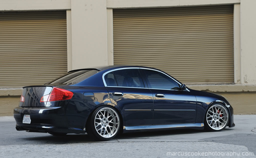

What kind of rims does this dude have on his G35?
I've been looking at these:
http://www.readywheels.com/mrr-desig...5ab19d6d8.html
http://www.readywheels.com/mrr-desig...52484159d.html
But I really like the ones in the picture but don't know what they are any opinions?
2006 Black G35x
Attached Thumbnails Have a Question/s About Wheels/Tires/Offsets/Camber/Etc? Ask here::-4drmadness_vivek1.jpg
2006 Black G35x
They are Volk SF Winning
