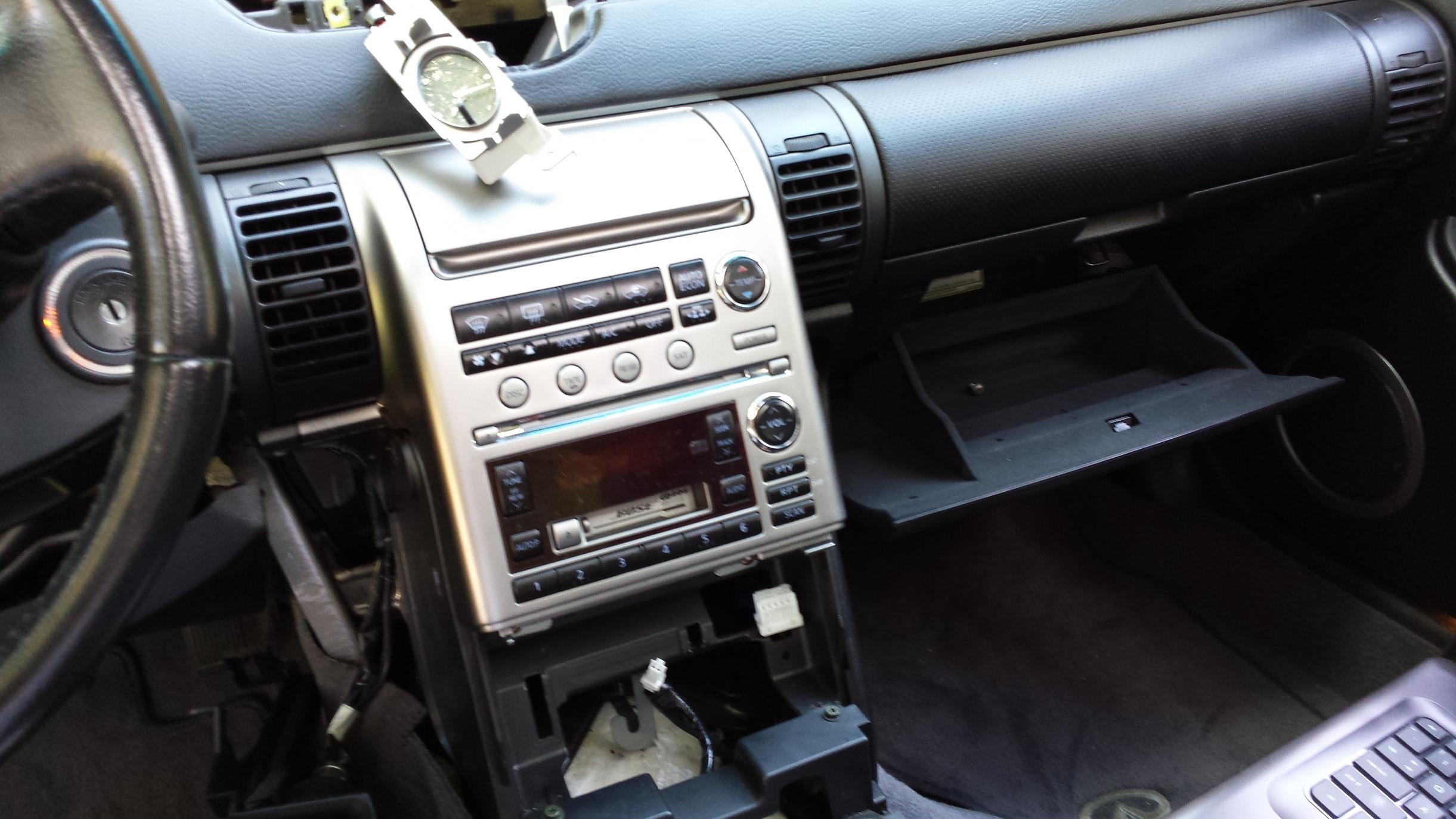

Great guide. The only issue I am having now is my air conditioner wont work unless it is set to 60 or 65, living in Texas this will put a large strain on my a/c compressor but I don't know what to do about it...
You probably disconnected the cabin temperature sensor.

From: DFW
That was it, thank you.
