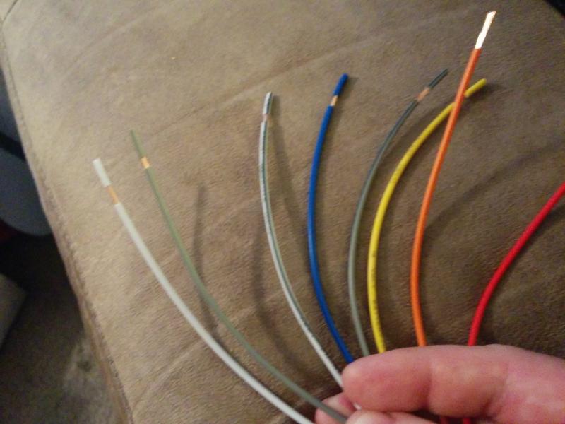

This is the main harness of my Metra 70-7550. Did they really forget a ground wire? This was sealed in original packaging and there's no black wire. Am I missing something?Name:  IMG_20141021_124140.jpg
Edit: nvm, I just read the back of the package. "If black wire is not present, ground radio to vehicle chassis". How do I do that? Haha

Just take the black wire from the new radio's harness and attach it (along with the other ground wires listed in my wiring chart) and secure it to a screw that goes into the metal of the chassis. The metal radio bracket works as a chassis ground.
