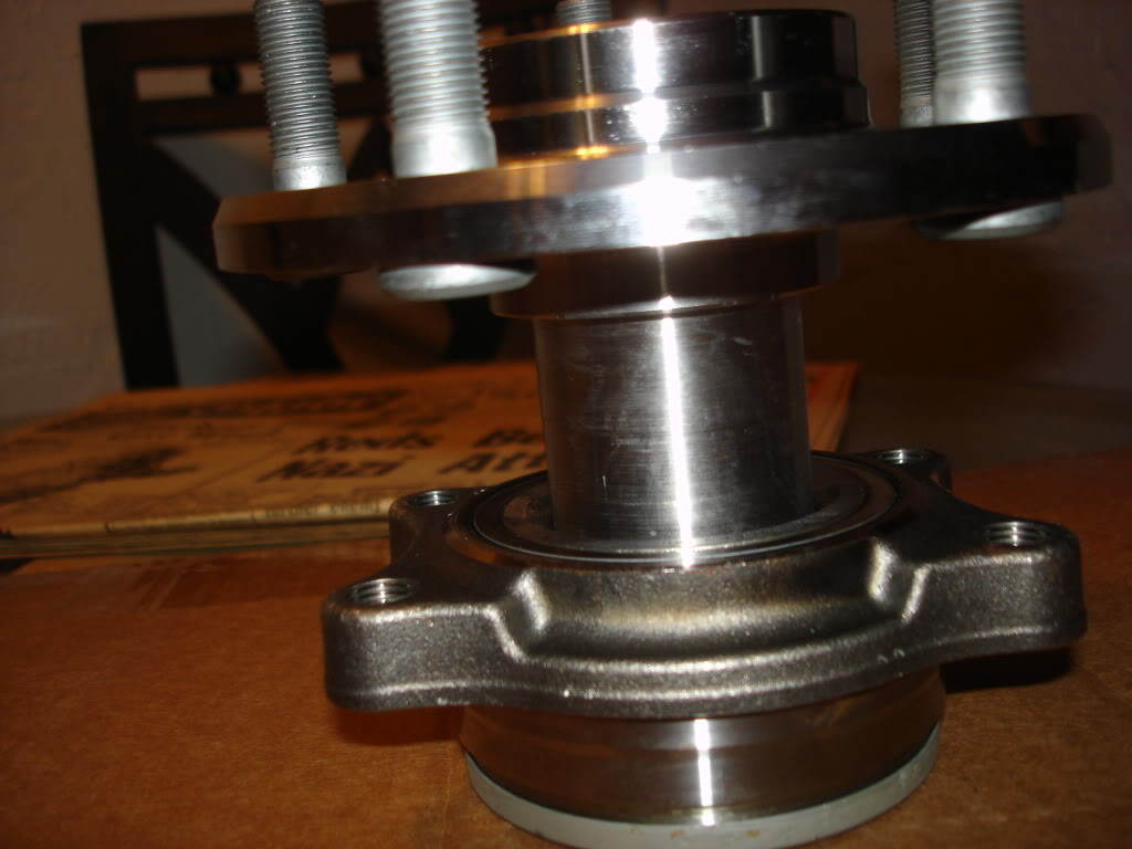

Ok, just to confirm...
Here's the front bearing (AWD) and hub. I'm basicallyu going to press the hub in until i bottom it out on the bearing face right? Makes sense to me, but just want a backup confirmation
Edit: got my answer...the flange on the hub does get pressed all the way in to the bearing face.

Old Jul 3, 2011 | 07:28 PM
  #128
Mustang5L5's Avatar
Posts: 8,818
Likes: 468
From: Taxachusetts
Doubt it.
Everything if seen calling it a hub assembly has been one or the other...not both.
Vie only seen them sold separate, bearing and hub, except 2wd front. Everything else you will need to press.
I just pressed my front awd bearings and hubs today....was easy. 10 mins worth of work
